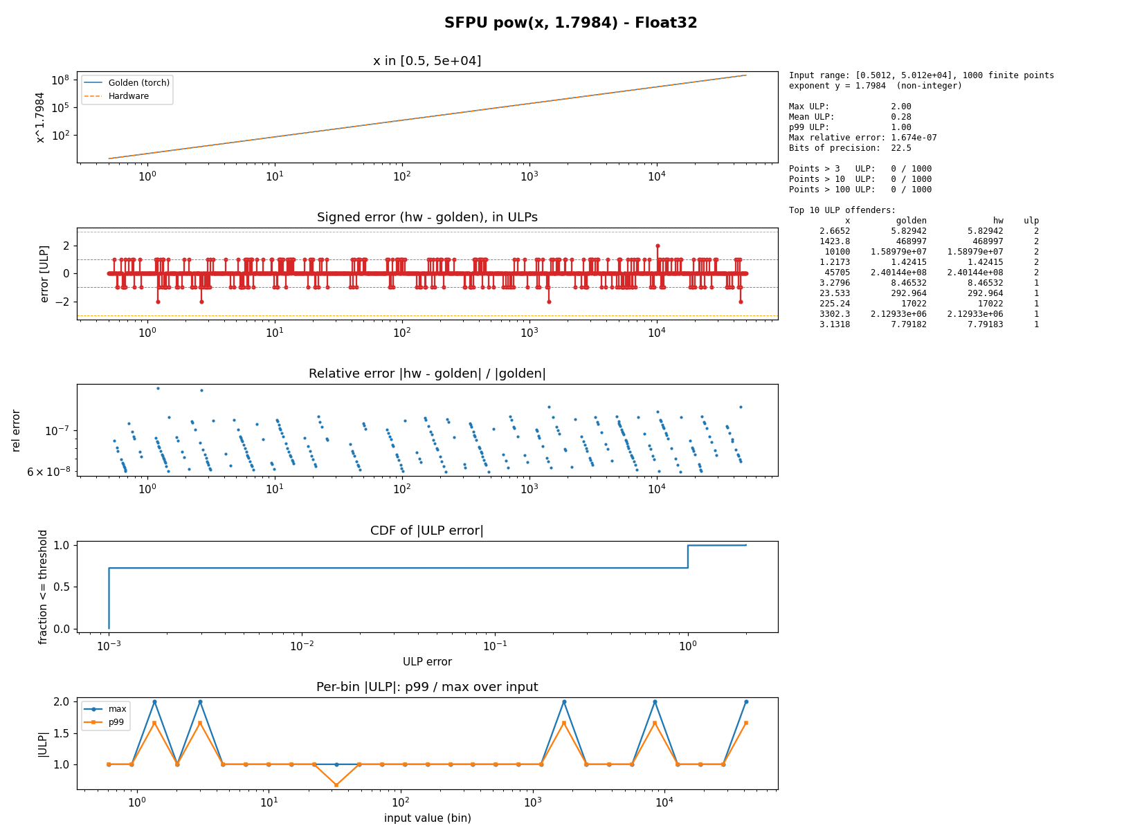

This PR is a follow-up accuracy improvement on top of the accepted #25025 fix, in the same class as the transcendental accuracy bounties exp2 #46006, expm1 #45046, atan2 #41029. It brings all tested non-integer exponents to within 3 ULP — including the long-mantissa 1.7984 CogVideo case (19 → 2 ULP) — while keeping integer exponents bit-exact.

1.7984 (CogVideo) 19 2 0 / 1000 0 / 1000

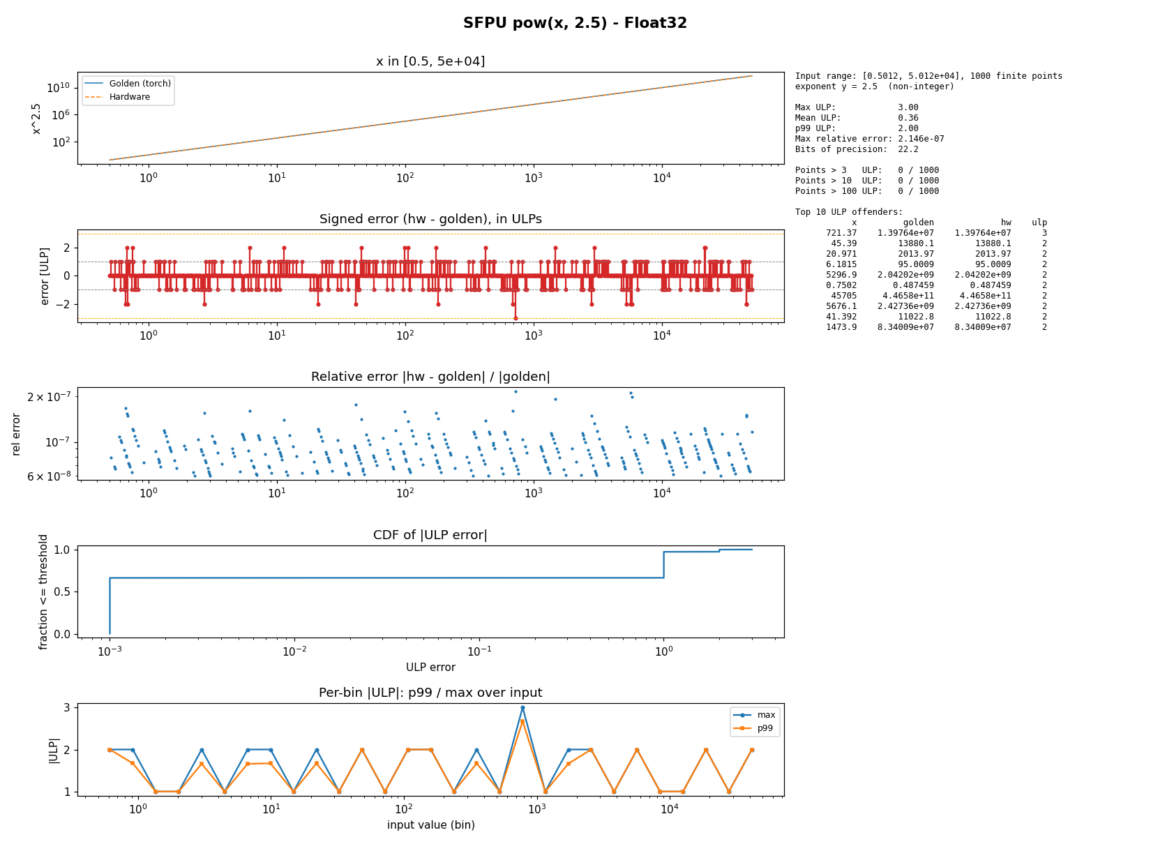

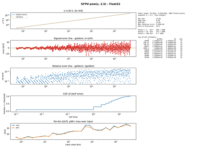

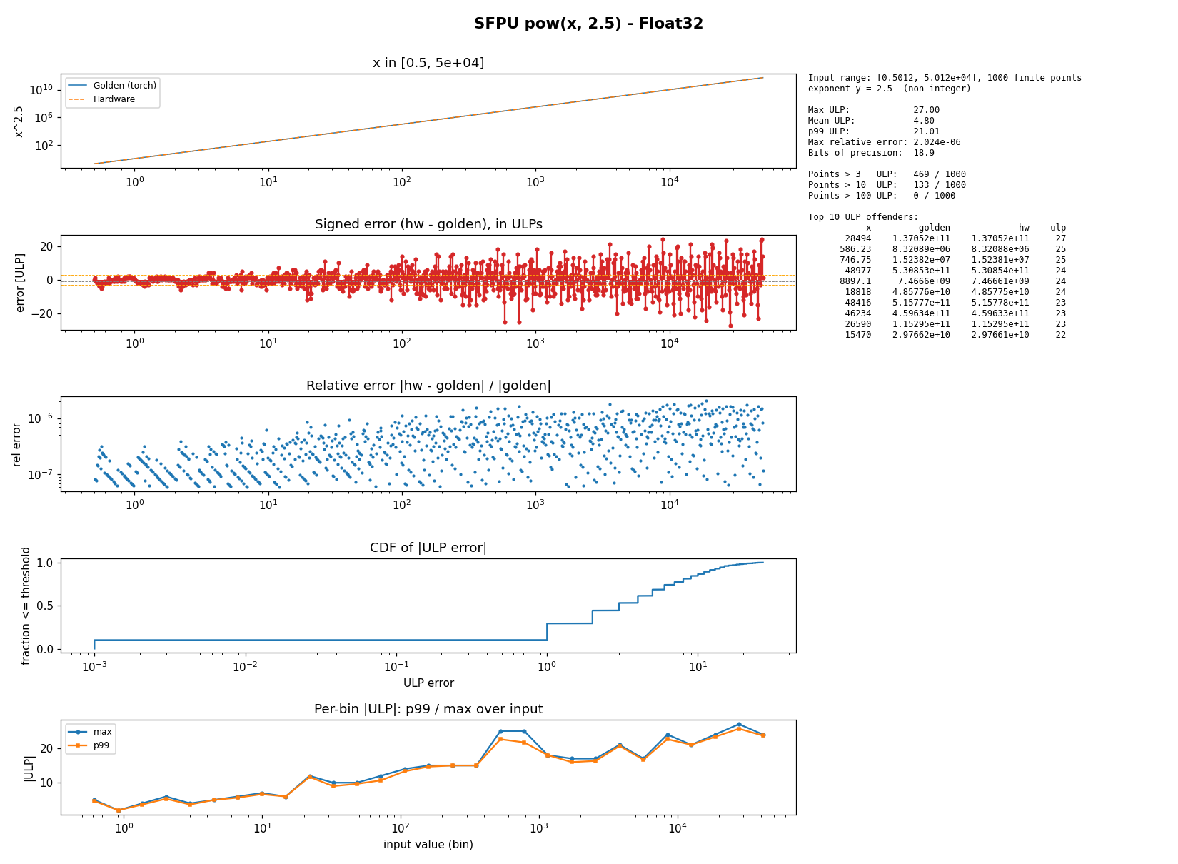

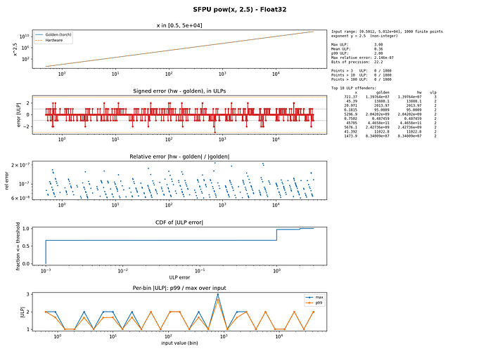

Accuracy sweep for pow(x, 2.5) fp32, before vs after the fix. Before: max 27 ULP, error grows with x (compounded log2 + exp2 rounding). After: max 3 ULP, mean 0.36, 0 points > 3 ULP.
Before (#25025 implementation):
After (this fix):

  1. Carry z = y·log2(x) as an unevaluated double-float (z_hi, z_lo) instead of one fp32 — z_hi the large integer-valued term, z_lo the fractional term. A register-frugal helper _sfpu_pow2_f32_accurate_hilo_(z_hi, z_lo) uses Knuth TwoSum (branch-free, exact) to form s = round(z_hi+z_lo) and its exact residual e, reduces s by k = round(s) (s − k exact by Sterbenz), adds back e, then feeds the reduced small argument into the existing Cody-Waite 2^f polynomial and scales by 2^k via setexp. The tensor–tensor path feeds the same reduction into _sfpu_exp_fp32_accurate_.
  2. Veltkamp split of pow (2^12+1 splitter) so the pow · exp_f32 product is exact. exp_f32 is the base’s integer exponent (a small integer); splitting pow into a 12-bit hi/lo pair makes both pow_hi·exp_f32 and pow_lo·exp_f32 exact (12-bit half × ≤7-bit integer fits a 24-bit significand), so the low partial product rides in z_lo and no bit of the large integer term is lost. This is what fixed the long-mantissa 1.7984 case. Only pow is split (not a full Dekker two-product on log2(base)) to keep the simultaneously-live vector count within the SFPU register-allocator budget — a full two-product on the 16×-inlined kernel triggers a maximum number of generated reload insns ICE on Wormhole.
  3. Third Newton-Raphson iteration on 1/(m+1) in the log2 series, driving the reciprocal to full fp32 precision and removing the residual floor that kept 1.5/2.5 above threshold.

  • 1.7984 (CogVideo) 19 → 2 ULP — solved via the Veltkamp split of pow (partial two-product) that stays inside the register budget.
